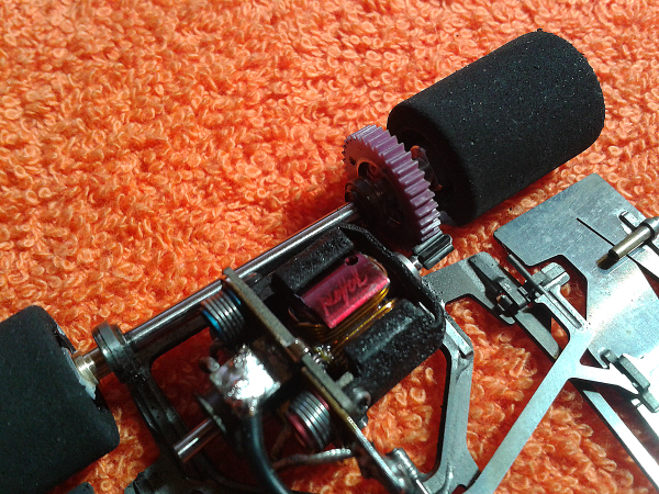

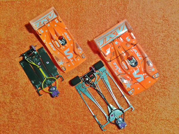

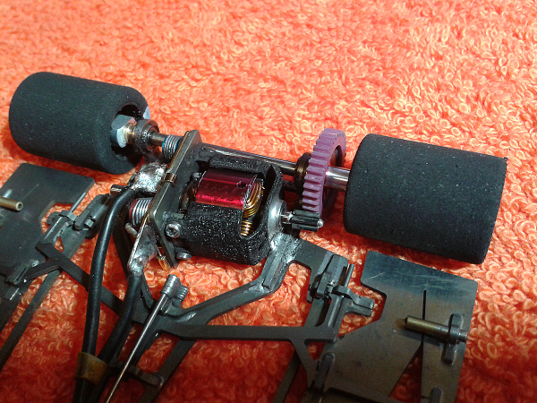

Tässä vielä saamani Cahozan mainoskirje, jossa kerrotaan hieman enemmän tsekkien kalustosta varsinkin moottoreiden osalta.
We would like to share with you the experiences and results from this year's ISRA World Championship held in Czech Republic and from the whole season. At this Worlds were the most participants in all classes. The organizer ensured not only the perfect accommodation but also a nice venue to place the race track, pits and all services. The food was perfect and the closing ceremony night with food and music excellent. I rate this Worlds as the best ever in all the time that I deal with slot racing and it is already 45 years.
My company has supplied handout motors for Production 1/24 class, and as far as I know not a one failed. All motors lasted the whole race without any problems. My job for a period of last 1.5 years was based on fact that I wanted to build such motors which can compete with the PK armatures of which was the lack and in addition PK armatures struggle with lifting lamination quite often on fast tracks, which are increasing, and don't last the race. That's why I went through the development of different style setups for Eurosport 1/24 and 1/32 where I used Koford armatures and different design of magnets with different magnetic force. This work paid off, and it proves 1st place in the Eurosport 1/24 and 1/32 classes. Although in Eurosport 1/32 class we couldn't use Koford armatures due to inaccurate balance, so we used more or less tested PK arms which at the end performed very well. My driver Tonda Vojtík Jr. (TKV) used these motors, and as the next also used Cahoza carbon fiber plastic rims, Cahoza cut down nylon guides, Cahoza highly durable gears and Cahoza nitrid titan pinions. As a first in the world I used armature shaft grinded to 1.2 mm and the gear ratio of 5/36 64 pitch (already at Warm Up Race).
As a business owner and producer I am glad that my products are popular for many years and I always try to further improve and develop best products for slot racing. I would like to also thank the drivers who believe my products and use them. Hereby I also thank my team: Tonda Vojtik Sr. who is engaged and makes the great rear tires for the team, and of course Tonda Vojtik Jr. (TKV) my driver, who proved to be a world leader and with a good quality material can win the World Championship and beat the more experienced drivers. However, this is not the only success of our work. During that period of last 1.5 years we have also won many other races here in Czech Republic including 1/24 Czech Open 2014, ISRA Warm Up Race 2015, Czech ISRA Nats 2015, as well as UK 1/24 Nats 2015 and Italian Masters 2015. TKV holds track records in Sweden on 3 tracks, in England on X-Track and on ISRA 2015 track. All this speaks to the high quality of Cahoza products and quality of team Cahoza.
Josef Hajek - Cahoza company director
Worlds 2015 specs:
Eurosport 1/32
Motors:
Qualification + Heat: Horky 14 mag + PK 25/25,5
SemiFinal: Cahoza 14 mag + PK 23/25
Pinions: 6T 80P Cahoza nitrid titan
Gears: 44T 80P Cahoza Highly durable
Rims: 11 mm Cahoza carbon fiber plastic
Rubber: Speedshop
Eurosport 1/24
Motors:
Qualification + Heat: Cahoza 24 mag + PK 19/25
Semi Final: Cahoza 24 mag + KOFORD 18/24,5
Pinions: Q+H: 6T 80P, SF+F: 5T 64P Cahoza nitrid titan
Gears : Q+H: 45T 80P, SF+F: 36T 64P Cahoza Highly durable
Rubber: Speedshop
